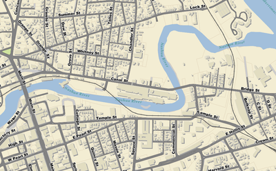

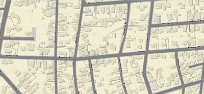

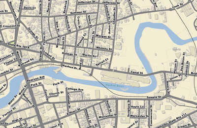

I have a long-standing issue with my vector tiles that I've been trying to resolve. The issue is that I design my label classes in Pro and get results that I like. However, in the published vector tiles, there are invariably high densities of repeating labels at high zoom levels (see examples below). I've gone through the suggestions in https://pro.arcgis.com/en/pro-app/latest/help/mapping/map-authoring/labeling-in-vector-tiles.htm and made adjustments accordingly, but I still see this issue. I suspect there's something simple I'm missing. Does anyone have a good suggestion?
I'm working in Enterprise 10.9.1, publishing from Pro 3.1.3, but this has been an issue for years.
Desired:
Actual:

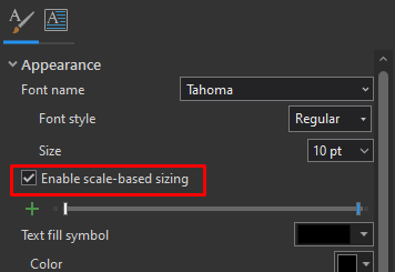

Could you please try Enable scale-based sizing and remove duplicate labels in label setting:
