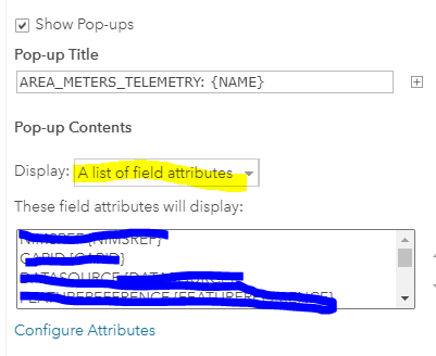

I want to continue to use the A list of field attributes option, with the output of this expression:
I have successfully done this but instead of just a string i want the result when 'YES' to be a hyperlink.

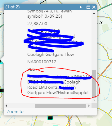

After figuring this out I tried the following:
var removespaces = Replace($feature.FULLNAME, ' ', '%')
var link = 'http://telemweb/graph/' + removespaces +'?Historic&applet'
IIf($feature["TELEMETRY_MATCH"]=='YES', link , 'Currently not linked to telemetry')
However it does not return the correct output, it now just says no information available, is this % a special character, if I use ? the popup displays, although not the correct url:
Example of full name :
NWA1A BTCC C Diamond.Coolagh Road LM.Points.Coolagh Bolie Flow
Example of full correct url:
http://telemweb/graph/NWA1A%20BTCC%20C%20Diamond.Bolie%20WPS.Points.Analogue%20Inputs.Pumped%20Flow?...
higgy7
**UPDATE**
Using %20 worked, the link says more info but i can live with that if this can't be changed.
