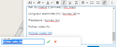

I'm making a WAB application on Map Viewer for Enterprise v10.9.1.
I'm trying to add in a pop-up the text from several fields and at the end a link to an URL coming also from a field of the feature by using the tool while configuring the pop-up.

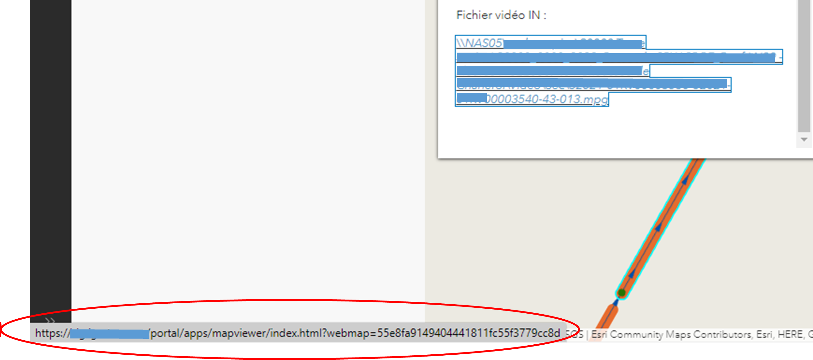

When I run the application I can see all text information and also the text of the URL, but when I click on it I'm redirected to the application itself (???).

Anghela,
        If you are building a WAB app you should be using Map Viewer Classic to configure your web map and pop-ups.  Alternatively, you could use your web map in an Instant App or Experience Builder.
WAB and Map Viewer Classic were built with ArcGIS JavaScript API 3.x.
Experience Builder, Instant Apps, and Map Viewer were built with ArcGIS JavaScript API 4.x.
Bernie.
