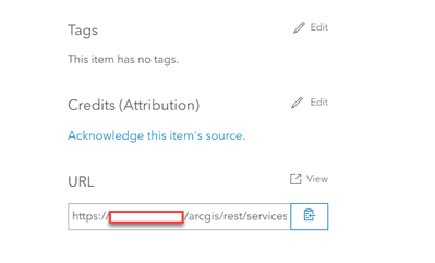

Hi @jfinnegan_hvilletn ,
When you say you are unable to access the portal item, can you elaborate?  Are you getting an error trying to add the layer to a web map?  There should be a URL in the details page of the service:
Are you able to access the Details of the service?
