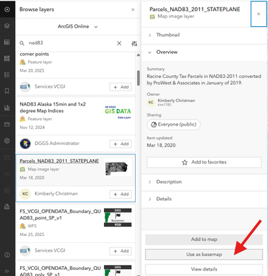

EmilyGeo
Hi @RogerDunnGIS
Could you try adding the layer with the Use as Basemap option?
EmilyGeo
Hi @RogerDunnGIS
RogerDunnGIS
Oh, for heaven's sakes.  Yes, that did it.  (palm to forehead)
