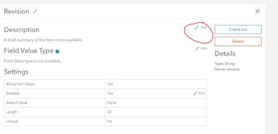

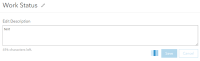

we have had issues with this as well, related to the "description" for the field. If you add something in the description for the field, even if it is just entering an empty space, you will probably be able to save your domains.edit the descriptionedit the description
Michael_Kraus
Thanks for confirming this as a another 10.9.1 bug.  When I try the workaround of editing the description, my portal screen just sits waiting when I press the save button of the field description, so I can't seem to employ this workaround to get around the bug.  I have tried seeing if I can edit the description or domain in Pro, but no good for a hosted feature layer.  Is there a behind the scenes, eg  REST interface, way of adding a field description or the domain?

Hola, es justo la ventana antes de entrar a la definición de lista, es en la descripción del campo.
