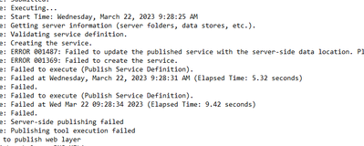

I haven't been able to publish to portal for months now. I can successfully publish from file geodatabases, and I can copy from my sql database, but cannot publish referenced data from the sql database. I know this was possible in the past.
I've upgraded by database, I am using my editor login to the database with portaladmin login. My databases validate before I publish and then I get the error when trying to publish, go back to validate and they are no longer validated.

What services are running on the ArcGIS Server? There should be a publishing service with Ex
If you've upgraded, could be an issue with the data store (db) registration
https://community.esri.com/t5/arcgis-enterprise-questions/arcgis-server-unable-to-publish-map-servic...
Another example here tied to connection details and naming of services/layers:
https://community.esri.com/t5/arcgis-enterprise-questions/error-001487-when-publishing-some-featurec...

Datastore seems to be working fine. Related to the 2nd link - most everything from my database was published to portal last year. I mainly want to republish maps to sort of group layers together. Essentially need to delete these layers that were previously published and try again?

My suggestion might seem unreasonable, but I would try to unregister the database from the ArcGIS Server and register it again.

Not sure how to do this. The x is grayed out on all of my connections. I did try to add the connection again from another location.

Seems like your datastore is not validating. You would want to register the datastore connection:)

The datastore does validate and I haven't had issues there. It has to do with the sde connections
RaymondHuang_Sg
It seems the existing SDE connection string is no longer valid. This could be due activities such as password change to the account that was used to create that SDE connection file, or other less likely activities such as changes to port accessibility on the EGDB, or the privileges of the user mcgis. In any case, you may consider the approach of creating a new SDE file using the existing credentials via the Create Database Connection (Data Management) tool to verify if the credentials are still valid. Let us know?
