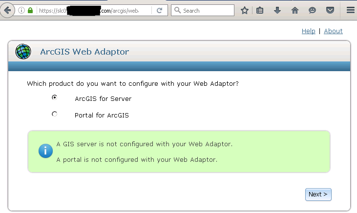

I am trying to configure web adaptor and portal together but getting this error (screen shot below)

Also, WebLogic is running on 80 and 443 port as esri documentation. I can see the web adaptor options
IIS is stopped to free 80 and 443 ports.
Even it gives the option to put my portal URL, Admin User name and password of admin user. When I put all the portal url, admin username and password and click on Configure, it shows a error message (screen shot on top).
