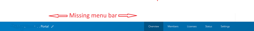

The top navigation menu bar in portal is missing. I'm on 11.2 (fully patched) and it was working fine. Then it just stopped displaying. I've cleared the cache and tried on Chrome and Edge. When accessed from a browser on the server the navigation menu bar displays fine.
Any help appreciated.

This is a known issue with the latest builds of Chrome, a deprecated feature used to display that bar was removed. There should be a hotfix patch available for your deployment.
DanCamboia
Thank you. It's working now. I had installed the patch, however, I didn't wait long enough before clearing my cache and retrying.
