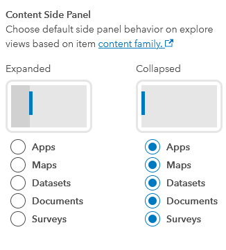

JenniferAcunto
Go into the site Settings.
Expand Interactions.
Scroll down to the Content Side Panel and select collapsed.
Configure Interactions
- Jen
