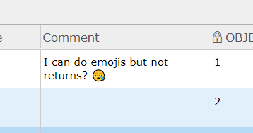

Hi All,
A user asked me how to enter a carriage return into a text field in Portal. You'd assume you could do that right? I haven't been able to with the usual tricks. i.e Shift/Alt/Ctrl + Enter or by copy/pasting multiline text from Notepad. Portal just reformats it as a space. What my user wanted to do was a little dot point list in a comment field which I think is pretty reasonable. I went back to field creation in Pro and could only find just a simple 'Text' field.
Is there a way to do this, and if not can anyone think of a suitable workaround?

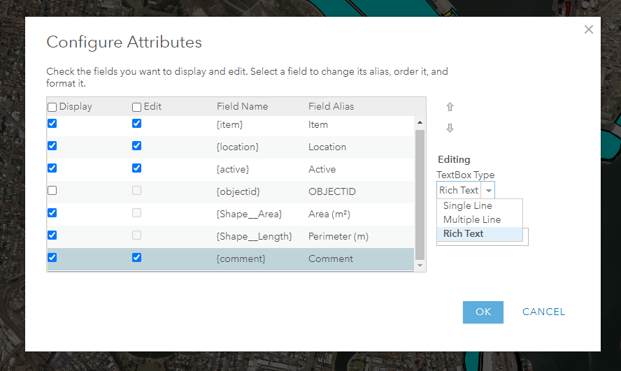

James_OKane
You're right @jcarlson. I ended up configuring the popup to use the 'rich text' edit type for my comment field (see attached). Works great as my user also wanted to use dot points. It doesn't appear as an option in Pro, only the portal.
