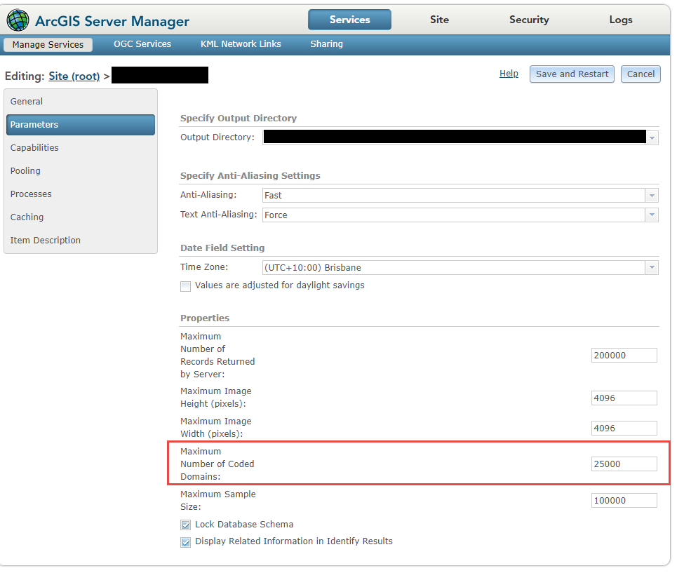

@AnthonyTomAnoba , I would suggest you up the Maximum Number of Coded Domains setting in Service Parameters setting in ArcGIS Server Manager. The default is 25000 and if you have more features than this, you will only see the domain codes in the service, just like what you are reporting.
Here is where to look in ArcGIS Server Manager:
https://enterprise.arcgis.com/en/server/latest/publish-services/windows/edit-map-service-settings.ht...
