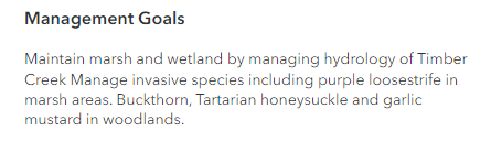

However, the variable v to concatenate doesn't seem to be working correctly, and just returns one long string:
Which part of the process is failing me here? I've tried a couple other ways to do this, but if there's an alternative to achieving the result of having the attribute value broken out into lines (with or without the bullet character), I'd be happy to adapt.
