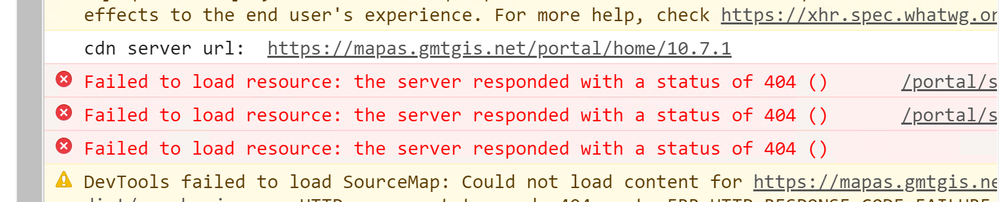

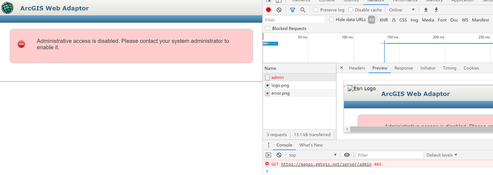

DiegoLlamasOlivares
Hello Travis,
I have implemented an Enterprise in  a single machine in AWS.  I am doing some test with this 10.7.1 Enterprise, and after this i shutdown the machine in order Amazon do not charge me for a machine i do not use.
But for some reason, everytime i turn of the VM, or I stop instance from AWS console, ArcGIS Enterprise get corrupted and I need to recreate my insulation again. I have tried even stom Portal, server and datastore services before turn off the VM or stop instance, but the problem continues.
Portal1.PNG Error I get from Portal
Error I get from server when I restart instance
and Data Store seems like never was configured with Server.
Any idea why it happend?
Thanks,
Diego Llamas
