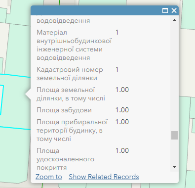

I have relation in two layers (building layer and table of item description - 1:M). When i configurate pop-up in Map Viewer classic i see statistic information (not real relation information). But in my map I want to use related layers instead of one because is more advantageous for what I need to do. I would like all the information of object to be displayed in a pop-up window, similar to ArcMap or ArcGIS Pro

The related records need to be aggregated in some way for them to show up in the "main" popup, though you can click show related records at the bottom to browse through the records.
If you wanted to show a list of related features, you can use FeatureSetByRelationshipName. You'll find, though, that you cannot have a FeatureSet itself be part of the popup. Instead, you'll have to access individual features or attributes to assemble an output string or array.
