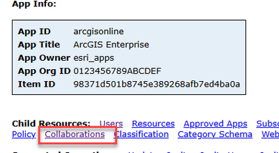

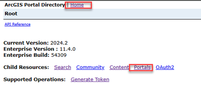

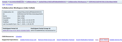

@GrantSmith122 you may get more information on the synchronization error by going to:
1.  https://<portal.domain.com>/<webadaptor>/sharing/rest
2.  Log into the Portal Rest API
3.  Navigate to Home > Portals
4.  Self > scroll down to the bottom and select Collaborations
5.  Go to Collaboration Workspaces > select the collaboration workspace > Sync Status
