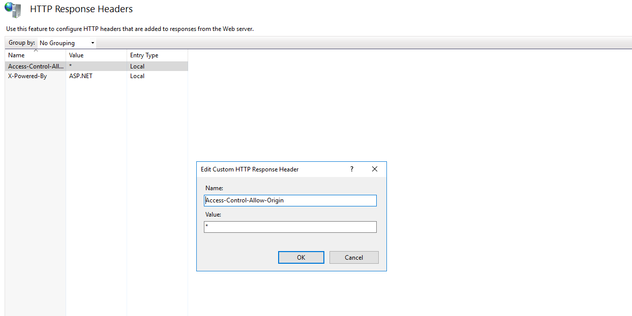

Hi there...i already solve my issue on sign in to the feature access..i hope this could help you all. what i do is change the value in IIS --> localhost --> HTTP Response Header --> Access-Control-Allow-Origin --> Add value * ---> Ok..
IIS --> HTTP RESPONSE HEADER
