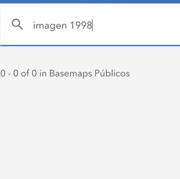

If I search for it is not there

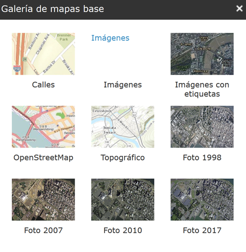

But if I look at the server services, is there
And in my app that is used i can see it there.
And i can use it.
there are 2 items that are missing, so  my question is how can i get this item back to portal and be able to search for it and selected in a new map?

DiegoLlamasOlivares
Hello @DeanHowell1,
After posting this question i remembered that option and I enter to portaladmin for each portal and run reindex and as you say, search index was not correct so after reindex two portals items were there again..
