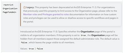

Esri keeps on changing how you can hide the Organization tab, so it's going to depend what version of ArcGIS Enterprise you're on.
For ArcGIS Enterprise 11.0-11.2, this article will help. At the bottom, it will take you to the Sharing API documentation page. Look for the restrictOrganizationPageToAdmin parameter you can configure.

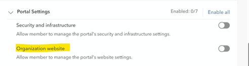

If you are on 11.3+, then you will need create a member role in Portal and then assign that role to the users you don't want to access the Organization page. Specifically, you will need to disable the Organization website.

DEWright_CA
No, this still allows you to go to the "Content" page and then see the "My Organization" and see all content that is shared even to groups you are not a member of.
