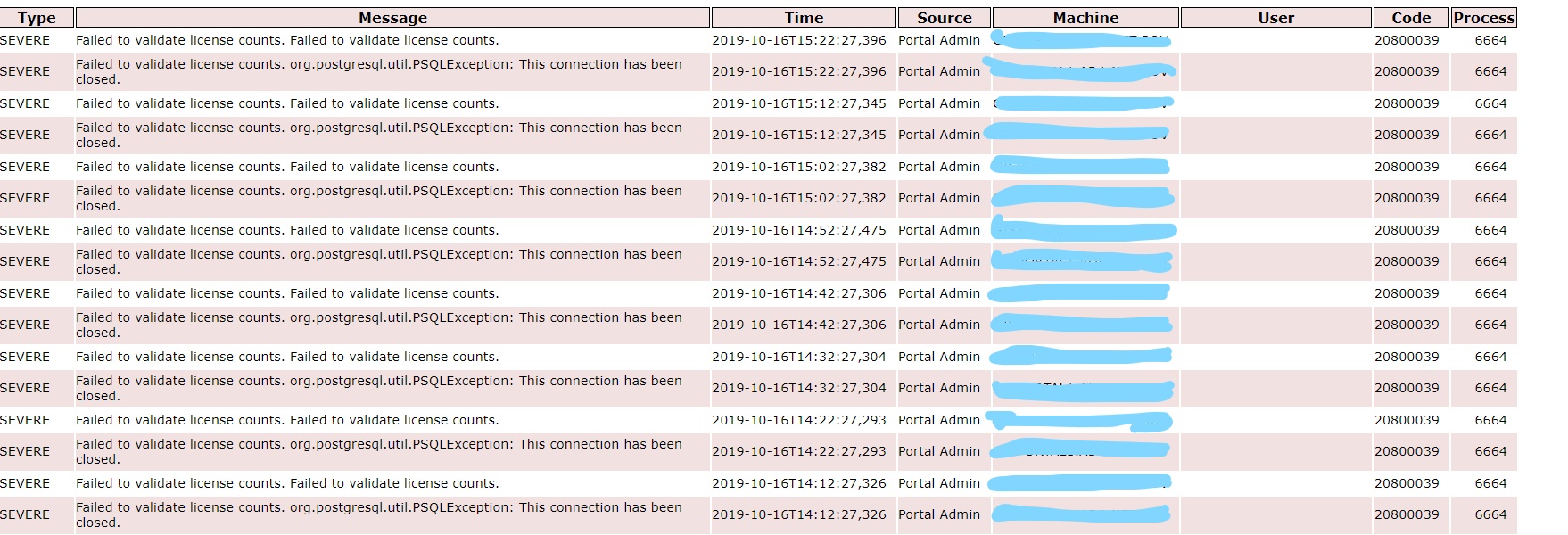

We are receiving the same two error's in our arcgis Enterprise Portal logs every 10 minutes on the dot saying "Failed to validate license counts. Failed to validate License counts". Followed by the next error saying "Failed to validate license counts. org.postgresql.util.PSQLException: This connection has been closed."
we are running an HA portal environment everything is at version 10.7.1 with 2 portal servers, 2 arcgis servers joined, and a primary and secondary relational datastore. If I reboot the primary portal machine the seconday machine starts saying the same error every 10 minutes. If I perform a restore of our enterprise using the webgisdr tool the error will be gone after the restore and it will stay gone until I reboot the primary portal server, when the standby becomes the primary the error comes back and does not go away again. This doesnt seem to be causing any issues with portal that I can tell except that its annoying and filling up my logs like crazy.
I have had a ticket with ESRI support open for about a month now and they still aren't sure whats causing it yet. Has anyone here had this problem or have any ideas what could cause it?
image of error

This is fixed at 10.8. The problem is the connection to the license information on the new primary/original standby becomes stale after a failover. Stopping standby and restarting the current primary would fix it. During a restore, the portals restart it makes sense that it would go away after a restore.

I stumbled on this post while troubleshooting an error with Portal.  The Organization->Members-> "Add Member" dialog window fails to load, just showing an empty screen. This prevents you from manually adding new users to Portal.  The only error in the Portal logs was the same the OP described "failed to validate license counts".  The environment also matched the OP - 10.7.1, Highly Available Portal configuration, etc.
The recommended fix of Stopping the Standby server, Restarting the Primary, and then Starting the Standby server does eliminate the license errors and fix the issue with "Add Member" window showing a blank screen.  So, this issue does have an impact beyond just cluttering the log.  If the Portal is having issues reading the license information, it makes sense that there would be issue with adding new members.
