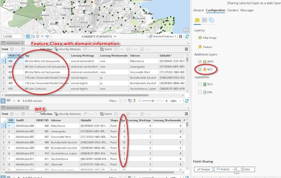

Hi,
I would like to publish a sde feature class with coded value domains as WFS service in our ArcGIS portal. Unfortunately I have noticed that the domain values are not resolved but only the codes are displayed.
Is there a way to display the domain values in the wfs instead of the codes?

One option might be to convert the coded value domains to use the description for both the description and the code. There may be other requirements which I haven't thought of, making this an unreasonable solution.
Another way to handle this would be: put the domain in a table of its own, use a join to retrieve and display the domain description then hide the two columns which display the domain codes. This would make for a second set of domains that would have to be maintained separately. Not ideal.
The page linked below shows how ESRI stores domains.
https://desktop.arcgis.com/en/arcmap/latest/manage-data/using-sql-with-gdbs/example-resolving-domain...
