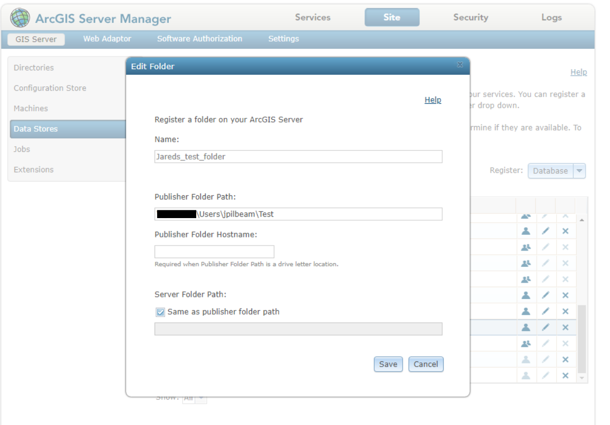

The solution in the help doc for this error mentions different ways for making the data accessible to ArcGIS Server. From the solution:
If you register the containing folder, you need to explicitly give the ArcGIS Server account permissions to read from that folder.
The data is in CSV format and I have made sure the local folder where it is stored is shared with our admin account. Also, I had my colleague register the folder with the ArcGIS Server account. Am I missing something?

When adding a folder connection to a folder with a path like "C:\Super\Amazing\Stuff" you have to also fill out that small box asking for Publisher Folder Hostname.  Open up command prompt on the machine, and type in "hostname", then copy that value and paste it in the box mentioned above.  This may not fix your issue, but sometimes errors are hiding behind each other and it could help flush them out.
