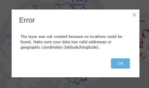

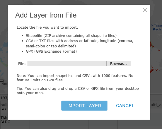

Hi, I am trying to publish an excel sheet in CSV format onto my organisation's ArcGIS Portal but I am having issues with adding my CSV file onto the portal.
I have 727 rows and 15 columns of data in my excel sheet. Whenever I tried to add a layer from my file on the portal, I would get an Error warning even though I have included valid addresses and geographic coordinates in my excel sheet. Did anyone encounter this problem too? I have attached some images for your reference, really appreciate your help!

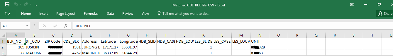

Also can you share any one coordinate that is available for the point data?

No, my csv does not have any special characters and my field names do not contain any spaces, I have added in underscores for the field names' spaces instead.
I have added a screenshot of one coordinate for your reference, thank you for your advice!

Ensure that the Lat/Lon values correspond to the coordinate values in GCS_WGS_1984 (Decimal Degrees). Try changing the lat/lon values to its corresponding values in Decimal Degrees, and add again to the Map Viewer.

you have projected coordinates... what projection are they in? and you should recalculate them into geographic coordinates in the source program
