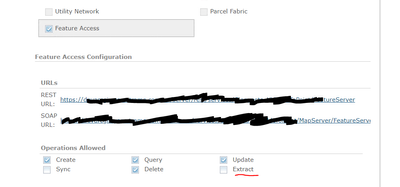

I do have EXTRACT unchecked, but this tech savvy user was still able to pull the entire layer. I guess I should watch his workflow. This is a real issue in our industry.

Technically, if a user can query your service, he or she will be able to save the query result, I don't think you can stop that from happening. However, you have control what information you want to expose in a query, where the query is initiated, etc.
