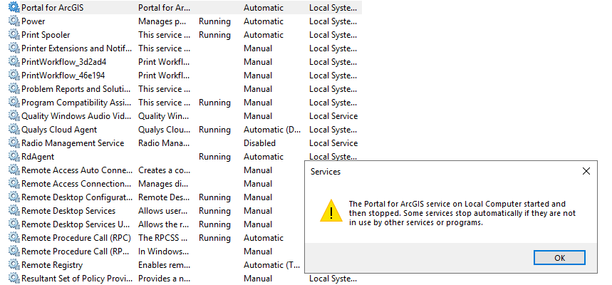

After successfully running the portal upgrade installation, clicking "Finish" button to close the Installation Wizard. As I am expecting the browser takes me to "Import License Files" page, just found out that the Portal for ArcGIS Service has stopped, and the service account was somehow switched to "Local System Account"
When trying to start the portal service manually, it throws the error message saying "The Portal for ArcGIS service on Local Computer started and then stopped. Some services stop automatically if they are not in use by other services or programs.".
Tried both GMSA and local service account to run the upgrade, still get the same issue, hence cannot start the Portal for ArcGIS service and cannot reach the https://**:7443/arcgis page.

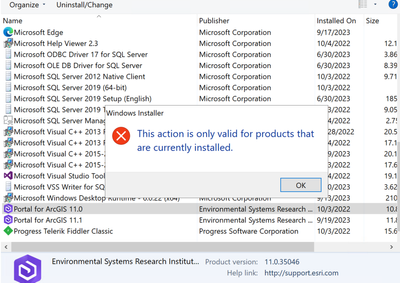

Just as a demonstration of how a corrupt Windows registry can mess up the installation of Portal for ArcGIS, here's a screenshot from one of these I recently ran into:
If you do elect to stay on the same machine, ensure the Windows registry is cleaned and the control panel list of installed programs is reporting correctly before installing ArcGIS Enterprise 10.9.1 again.
In my case, I also ran a sfc /scannow to check for any missing windows resources (which I had one missing.corrupt .dll). https://support.microsoft.com/en-gb/topic/use-the-system-file-checker-tool-to-repair-missing-or-corr...
An alternative method would be to move to another machine, this blog should help you move to another machine whilst maintaining a friendly DNS alias:https://www.esri.com/arcgis-blog/products/arcgis-enterprise/administration/migrate-to-a-new-machine-...
