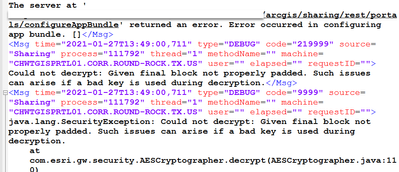

@Kathleen_Crombez - I just upgraded my Portal from 10.7.1 to 10.8.1 and am having the exact same error appear when I attempt to Populate License via Portal Admin:
Interestingly, the Portal logs show a decryption error:
How did your reinstall go? Did it work out the second time?
Kathleen_Crombez
@Mandalorian,
I never did figure out what caused the issue the first time. But the second time I did the upgrade it was successful. (Granted it did not go as smooth as I would have liked, but it was a success.)
We uninstalled Cisco AMP (antivirus), disabled Sophos (antivirus and file scanning), and disabled Windows Defender prior to the second attempt to upgrade.
