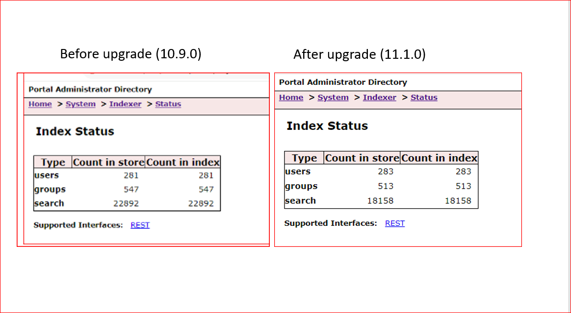

Just completed a HA enterprise upgrade (2 portals, hosting server, fileshare, 2 relational datastores and 2 tilecache datastore). It all looks fine, however the portal contents as seen in the index status is a bit puzzling.
After upgrade the groups and search (items) has come down. Is this normal?

Don't think this is normal.
If you check the index status on each Portal machine via port 7443 URL, do both machines report identical index status?

Hi @TimoT I checked both portals separately via 7443 and the numbers are same:
