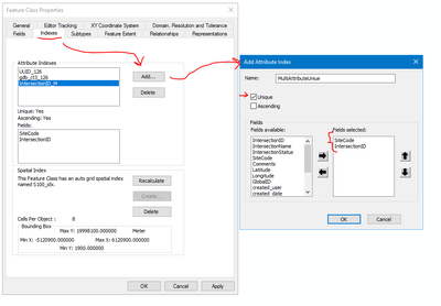

GerberMatthew
Hi Sara,
Right click the feature class and go to properties --> Indexes --> Click "Add" --> Give the index a name; Check the "Unique" check box; Select the attributes the accumulation/concatenation of their values need to be unique by --> Click OK.
I think this will only work when editing in "Online" mode where transactions are to the database.
