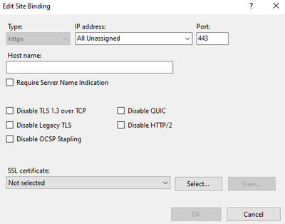

We're currently using an identical setup, 11.3 with Server 2019, I'm curious if you've been able to verify that the IIS server running the Web Adaptor still has its binding? Kind of strange I know, but our server experienced something like this as well, and it turns out it lost its SSL certificate!
This is about how it appeared, the Not selected was on the selection and it caused our Portal site to not boot up. In your case though it may be a little different, is the IIS server started as well? Also, since you mentioned you can't connect to the web adaptor, can you connect to the FQDN:7443 address?
