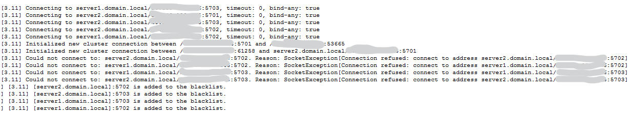

I also see the following occurring in the Catalina logs:
I have disabled McAfee for testing and internal firewalls are disabled, but the error still presented itself following serveral restarts.
