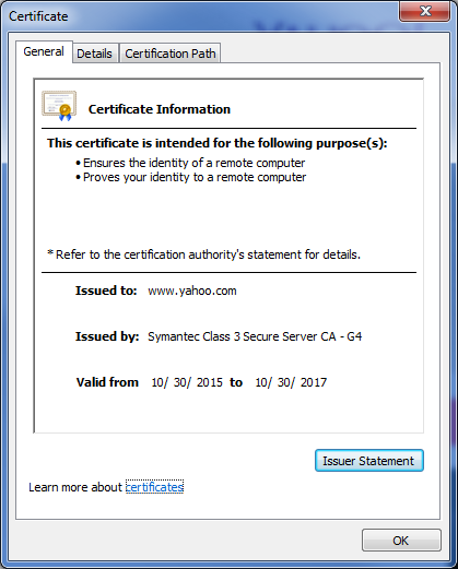

3. If so, click the green lock icon, you will get the following option. Choose "Connection".
4. Click certificate information.

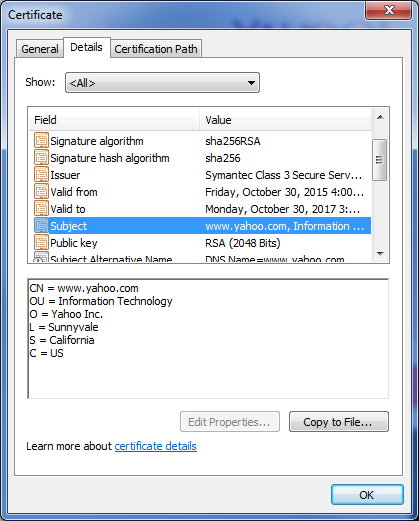

5. Choose details.
6. Scroll down to Field: "Subject".
7. Look at the value of "CN" in subject. If it's: <portal-domain-name> then good. If it contains " * " in the front, it's assigned as a wildcard certificate.
