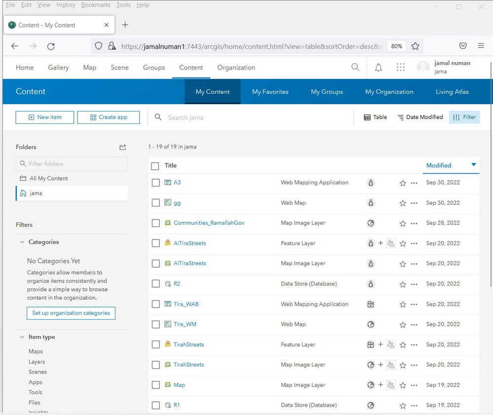

Portal for ArcGIS 11.0: How to identify the version of the Portal for ArcGIS?
For example, in the screenshot below, I couldn’t figure out how to identify the version
Jamal Numan

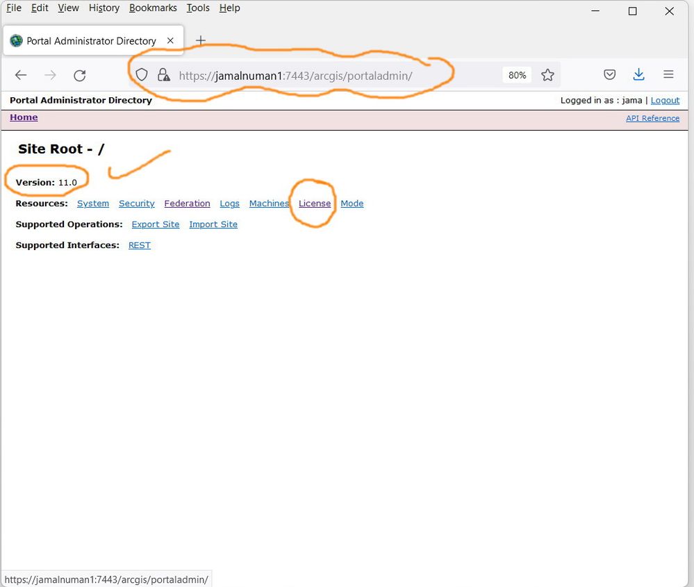

Hi Jamal,
two ways:
https://<fqdn>:7443/arcgis/portaladmin
shows the Version
or
https://<fqdn>:7443/arcgis/portaladmin/license
this shows the Version of the licenses being used.

MattWilkie3
To fetch the version number when not an administrator use REST api:
https://{domain}/portal/sharing/rest/portals/self
