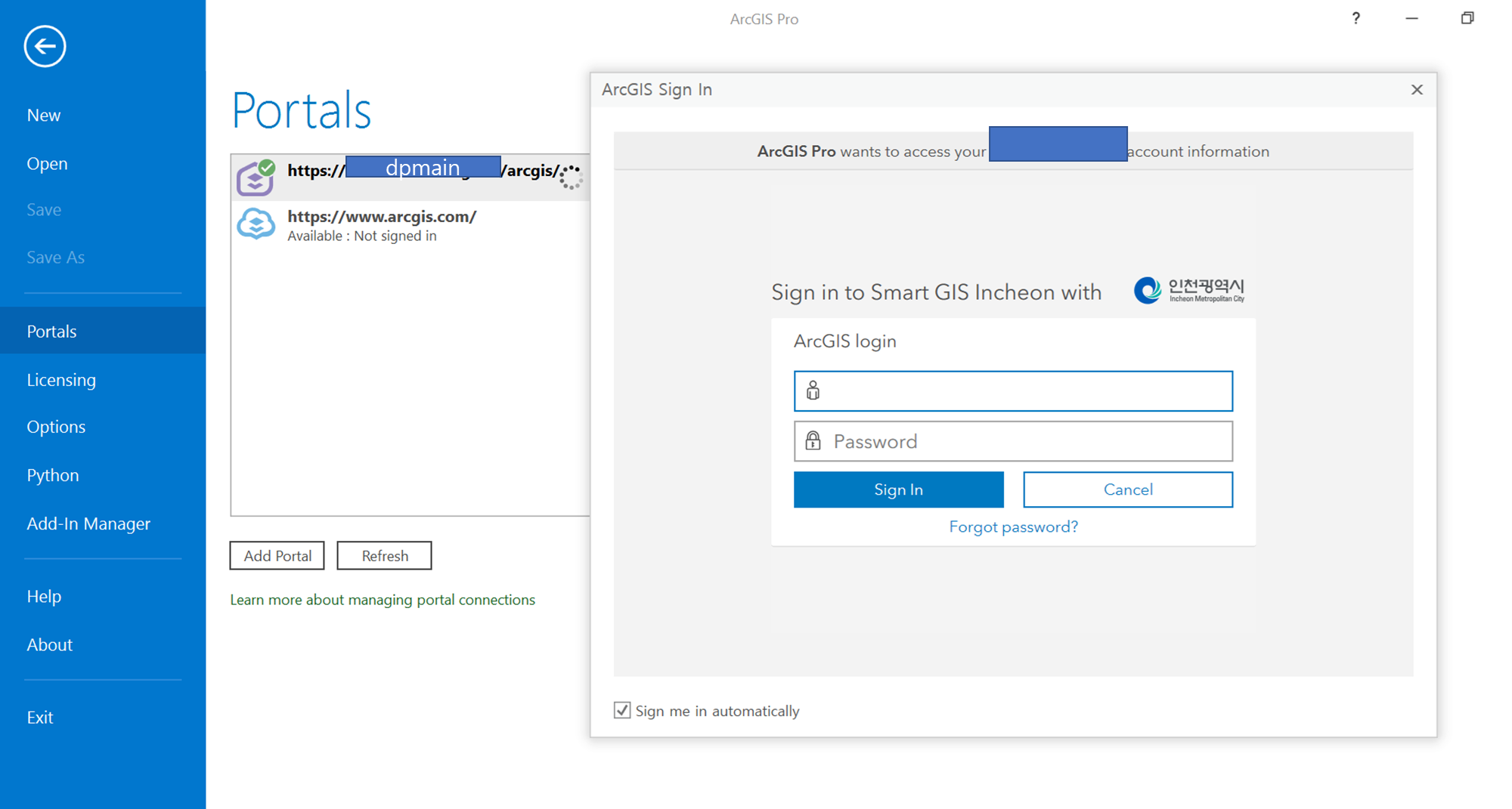

I have a problem with Portal for ArcGIS 10.8.1.
I cannot connect to my enterprise portal on ArcGIS Pro with my enterprise URL.
I cannot sign in with my enterprise account when the window as below appears.
Therefore, I cannot publish my layers to the portal.

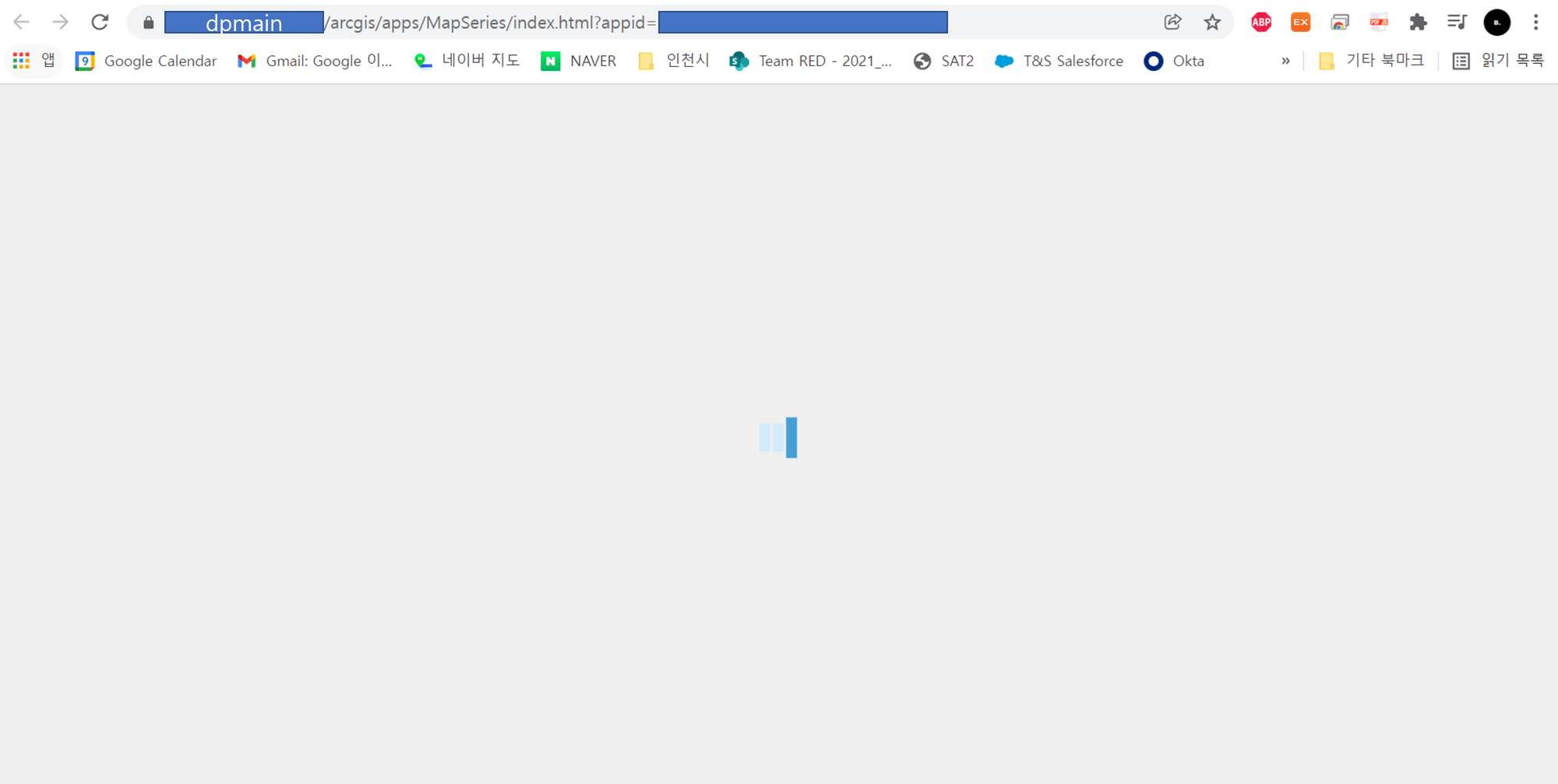

I cannot open storymaps on portal as well. It shows me a loading icon as below.
The developer window says "The application has to be accessed through a web server. Consult user guide for detail."

Unfortunately, the federation doesn't work. Now I am able to sign in the portal on ArcGIS Pro, but when I try to "Share As Web Layer", I see "Federated server not available" error message.
