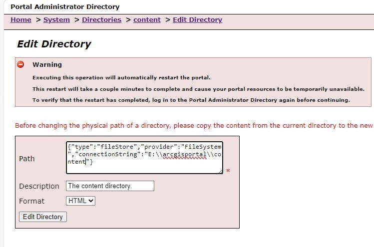

I notice there seems to be a disparity on the contents path showing on the portal admin and the one showing on my server.
The portal admin Jason shows this --- {"type":"fileStore","provider":"FileSystem","connectionString":"E:\\arcgisportal\\content"}

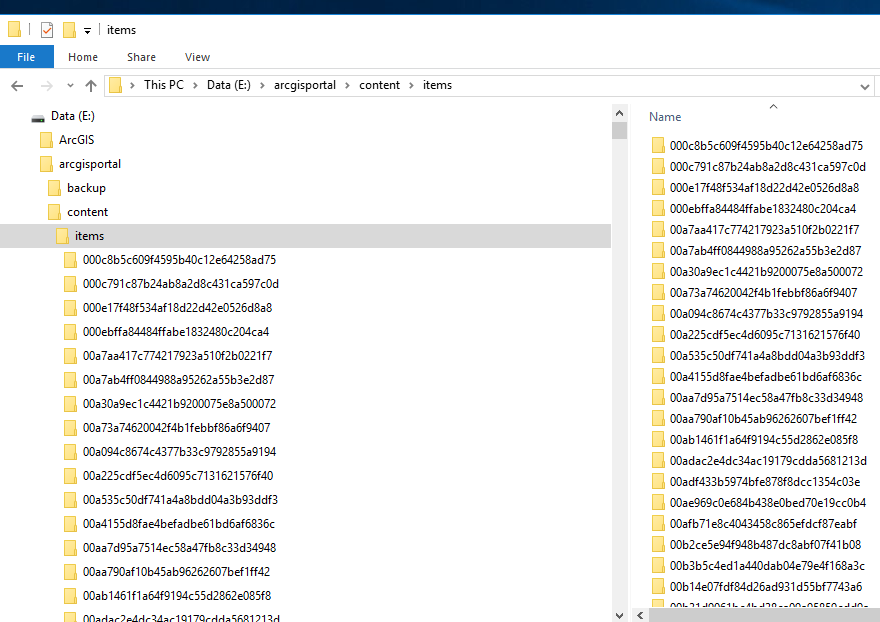

While the physical server drive shows this  --- E:\arcgisportal\content\items
Could this be the problem?? the next subfolder Items???

A_Wyn_Jones
That contents path on Portaladmin is correct. It's not the issue.
