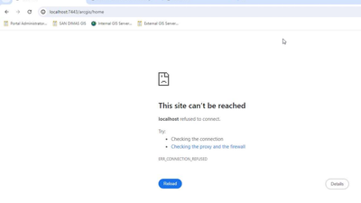

I have tried upgrading my enterprise environment all of last week but have been unable to get past upgrading the portal. Once the installation window completes and the browser is opened where I'm supposed to upload my portal license and finish the installation the only error that I get is this image.

I actually have tried the FQDN as well and it is still not working. The logs for the upgrade didn't produce any relevant errors either unfortunately. We have had a logging issue for some time where logs are not being produced.

Connection refused means the web server is not started. You can check the Task Manager to see whether the javaw.exe process is started. If you have multiple components on that machine, you may need to enable the Command Line column so you can see the path to the process to make sure it points to the Portal install directory. If the web server is not starting, you'll need to look at the web server logs under framework\runtime\tomcat\logs. You may also need to look at the service logs under framework\service\logs, as there's some initialization logic where if step 3 out of step 1-10 fails, and step 10 is starting the web server, it'll never make it there.
