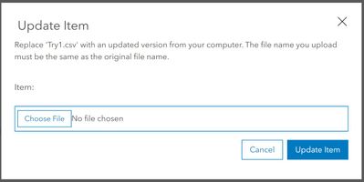

I have a csv that is hosted on our portal.  The csv does NOT have an associated feature service of any kind.  Looking through the documentation, I see methods for overwriting the feature service (Overwriting feature layers | ArcGIS for Developers) but if the file doesn't have a feature layer, I can't seem to make it work.
Can anyone please direct me to the documentation or have a Python example of updating a hosted file only?
I guess I can create a feature layer as a last resort, but I don't have any other need for one.  I only want to update the CSV file so users can download the latest version of the file.  The purpose is to share the file, not a service.
I'm looking for the Python equivalent of using the Update button.
