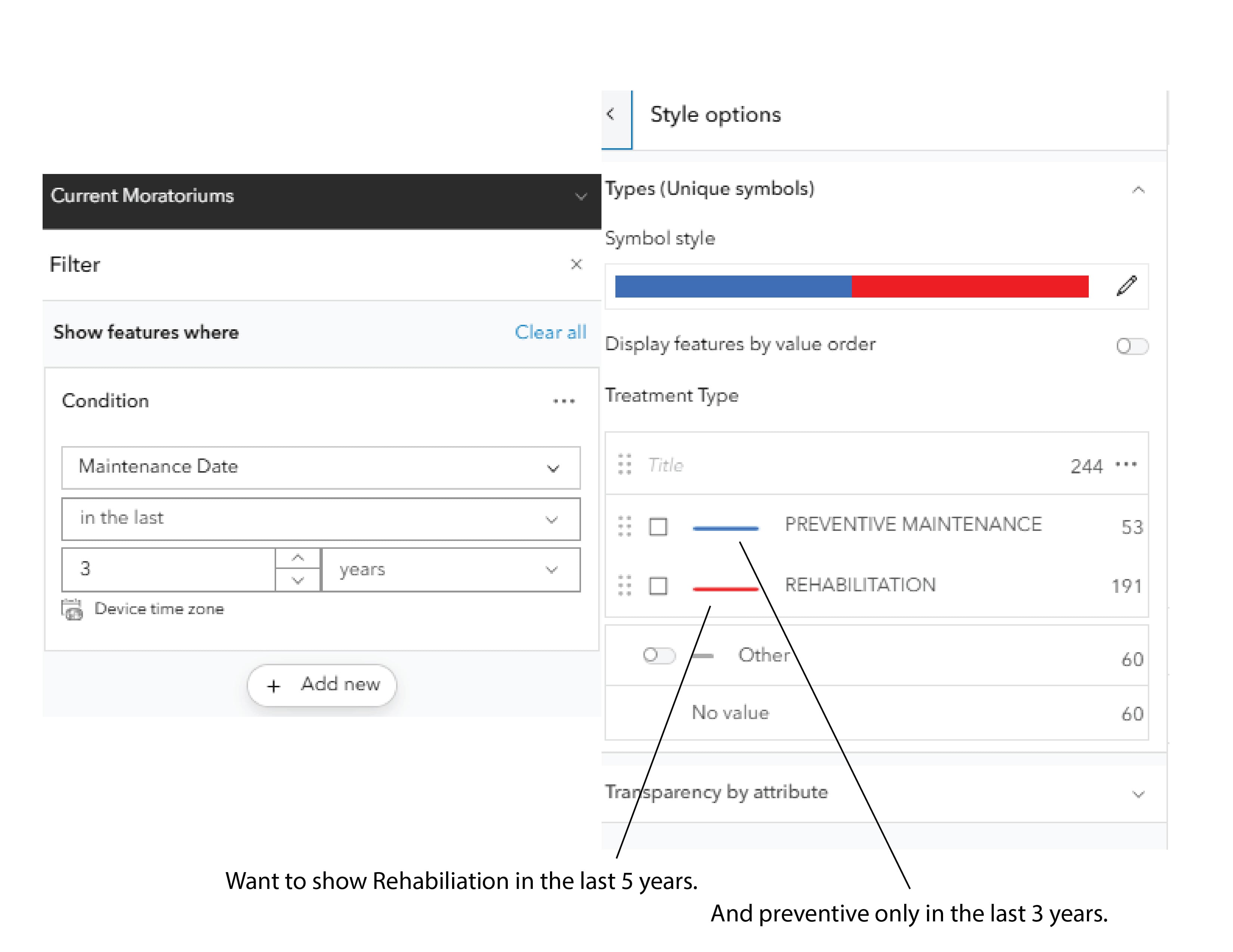

I have an issue in Map Viewer where on one layer, I am symbolizing two values. The issue is that I want to show all Rehabilitation segments within the past 5 years, but I want to show all the Preventive Maintenance segments only with the past 3 years.
I have one filter setup, use unique symbols. But I can't see how to apply a different filter to each unique value.
I don't want to create separate layers as in my app, with the rest of what is going on, it wouldn't work great. Preventive and Rehabilitation needs to be together on this Moratorium layer.
Thanks.

Hey @TimLohnes1
In your filter, would you be able to set it to something like this:
1 filter group:
Treatment Type = Preventive Maintenance
Maintenance Date in the last 3 years
2 filter group:
Treatment Type = Rehabilitation
Maintenance Date in the last 5 years
So basically separating these into two logical groups.
Cody

I was hoping that I was missing something easy. Thank you. I have this now. I don't think I knew about grouping.
