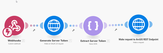

Andrew-Bowne
What I did was set up a scenario with a custom webook that connect to Portal, extracts the server token, then makes a basic HTTP Request to a feature layer through it's REST endpoint.  That "seems" to be adequate to keep the connection alive:
Then I have a Python script that makes an HTTP request to the custom webhook.  The script is set to run every day using Windows Task Scheduler..
