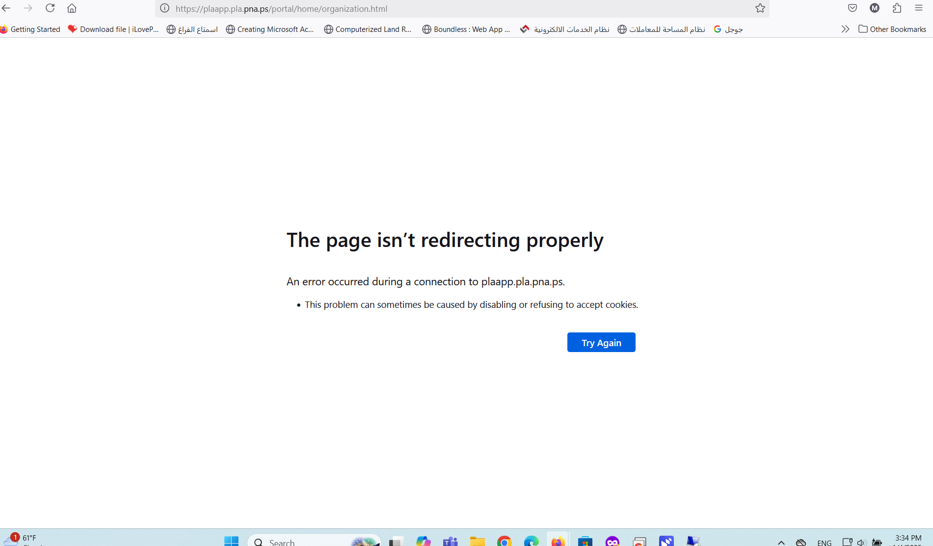

hi  i have arcgis portal 11.1 everything is work on windows server 2022 in vm  but when i try to open in web  to login i can't ( see pic 1 and 2)
tha smae think in arcgis server after login ( see pic 3) if i chane port  manual 80 to 443 its work for server
portal linke portal
server link server
thanks

We are using HTTPS only on port 443 for the portal and server.
Then the redirect isn't working
We solve this problem by making HTTPS only on Citrix Netscaler (WAF).

Regarding 3.png, you are mixing URL schemas tied to network protocols and ports.  Almost any website where you structure the URL as:
https://hostname:80
will generate a SSL_ERROR_RX_RECORD_TOO_LONG error, it is an expected error in that situation.
The HTTP protocol default port is 80 while the HTTPS protocol default port is 443.  If you leave off the port in a URI, it will use the default ports, hence why you don't have to type
https://hostname:443
when connecting to a website using HTTPS on port 443.
You have some kind of configuration issue on the network device receiving traffic for plaapp.pla.pna.ps .  In the 3.png screenshot, you are connecting to ArcGIS Server, which appears to be working if you don't mix protocols and ports.  For 1.png, you are trying to connect to your portal, and the redirect isn't working.
