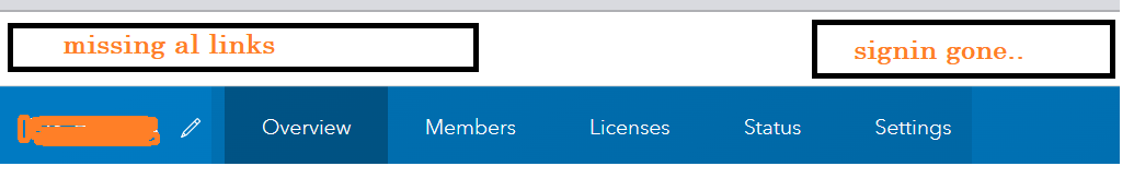

Suddenly Geoportal lost all links on top, including the signin link. This only happens in Chrome.
On Edge, it's completely normal
I have cleared all caches, histories and cookies. Then restart the browser.   But still does not work: all links on top still missing.
Need help. Thanks
