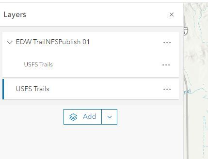

When we add a new Map Image Layer to a map, it shows the layer as if it is grouped or nested under itself.  You have to click the arrow on the left to open the configurable layer under it.  Is there a way to add the Map Image Layers without this drop-down so that only the configurable layer is displayed?  Here is an example of what we are seeing.  Only the bottom Lift Station layer can have its symbology, label, and pop-up configured.  I'm not sure what the point of having it nested is, but we would like to remove this.

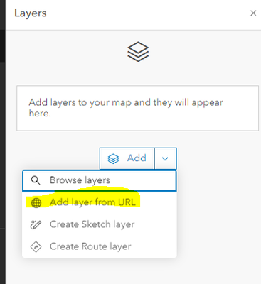

I'm guessing you added it be search for layers and adding it from that list? I agree I don't know why they come in nested, very annoying. You could add the whole URL from the REST endpoint?

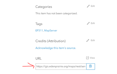

Hit View there and then make sure you select the individual layer you want, and just copy-paste the URL there.
So instead of <url>/MapServer you would have <URL>/MapServer[layerID]

We are trying to add the layers without using the URL to add them.  We used the URLs in ArcGIS Online and were hoping that we'd be able to grab them on Portal for an easier add without having to use the URLs.  Is there no way to make them appear unnested when pulling the Map Image Layer by browsing?

if you add the the url to the service to include the index number of the layer you want, you can avoid the nesting behavior. For example in the screenshot below, the two layers are the same service, but the bottom layer was added with the index number of the layer, ie ".../MapServer/0", as opposed to ".../MapServer"

We have published these referenced layers to our Portal so when we add them to the map, we are browsing for the layers and not adding them using a URL.

A URL gets created whenever you publish an item to the Portal. You can use that URL followed by the layer ID to avoid the nesting behavior. Just copy-paste it here:
