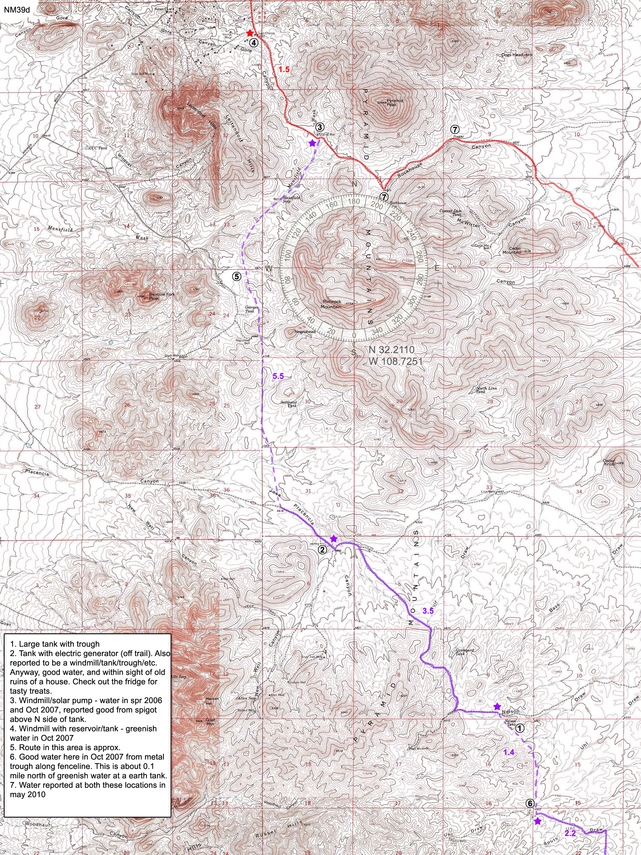

If you want to see an example of an existing map (done via photoshop layers), see here:
http://www.phlumf.com/cdt/nm39d.gif
This is about a 4.8MB .gif file. It's a section of the route in southern New Mexico. you can see the kinds of notes I have there now. I'd like to replace the compass rose with a GPS border, but other than that, the end result should be similar. (note the mileage labels, number labels, notes, etc)
