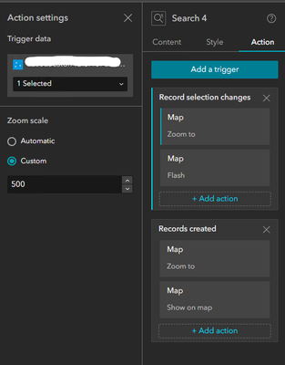

JeffLegato1
Yes! Using the Search widget in experience builder, you can set a Zoom scale in the Action settings for zoom to.
gis_mags
Ahh, thanks! Unfortunately, we have several different layer searches configured alongside the locator search. So I think a custom zoom scale would negatively impact the other search results. 😞
We use a locator not published by our own team. I'm wondering if the locators we are using have a slightly too wide an extent set, as described here Zoom to geocode results—ArcGIS Pro | Documentation
