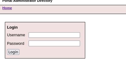

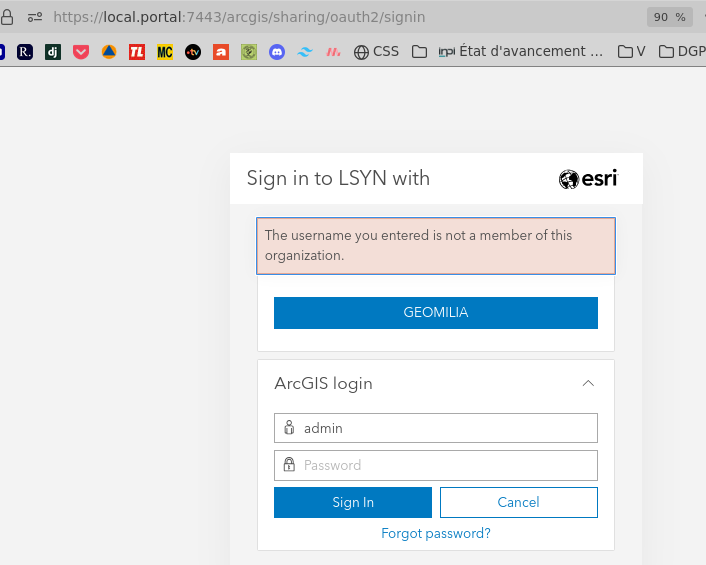

Hello,
When I upgrade a Portal from 10.7.1 to 10.9.1, "private" access to "portaladmin" (with machine name not fqdn) asks for "oauth2" login and answer "The username you entered is not a member of this organization." even with a good login and password. In 10.7.1, it was just asking a simple login password to access "portaladmin" from machine name.
I can still log in to portaladmin with fqdn after upgrade and every contents are working but I can't add a second Portal and use webgisdr anymore.

## 10.7.1
## 10.9.1

First of all, it’s normal for portaladmin to prompt for OAuth2 authentication in later versions of Enterprise..
Regarding your errors, I have seen something similar in an upgrade from 10.9.1 to 11.1 on Windows, so it may not be limited to Linux or version 10.7 of Enterprise.
The login error message you are receiving is not something you should see in ArcGIS Enterprise, and I believe only appeared in older versions of ArcGIS Online.
If you go to https://local.portal:7443/arcgis/home without logging in, does your navigation bar look like ArcGIS Enterprise's usual bar, or does it look more ArcGIS Online's as below
If it looks like the ArcGIS Online navigation bar, then your issue may be very similar to the one I've seen in the past. The issue was related to corrupt Portal items and apps in the content store upon upgrade. You might start encountering further unusual behaviors beyond failures with webgisdr and adding a second Portal.
