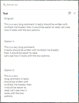

Here's how the two options look in a MapViewer popup:

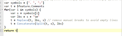

LarsElmkær_Chwastek
Hi Johannes,
I'm using the arcade option 1 and when I click Test it looks perfect. However when I open my pop-up, the text field hasn't changed. It is as if the expression isn't being read... Is there a step I'm missing? I've only changed the name of the field and then clicked ok.
