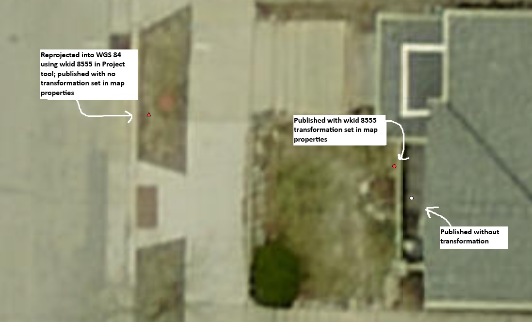

In the example below, I published the same layer three times:
  1. once with no transformation at all (white circle)
  2. once using the wkid 8555 transformation set in the Map Properties (red circle)
  3. once after having run the layer through the Project tool using the wkid 8555 transformation (red triangle).
The circle and triangle should been top of one another; however, in Portal they are offset:

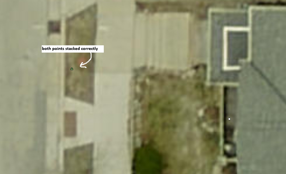

I do not have this issue when using other transformation paths. For example, here is the same process using NAD_1927_To_NAD_1983_NADCON (wkid 108001, latestWkid 1241):

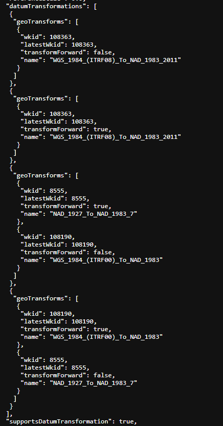

Any ideas why this is occurring? The layer's JSON does indicate that the data is being published with the transformations I think they are:
