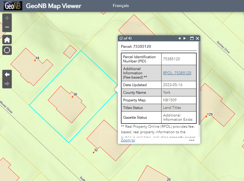

      Map image layers (a.k.a. a map service) support pop-ups.  Here is an example with our parcel map layer.
All of the pop-ups in this WAB app use a map image layer.

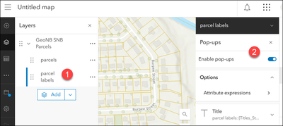

TanuHoque
@DanaBissey1
Just checking in Map Viewer, did you enable popup for sub layers inside a map image layer?
