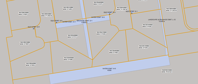

The issue is that suddenly there are some labels that are not showing in the map service while others are....
This label expression publishes perfectly, just like it always has:
[ENCUMNAME] + "\n" + [STATEDAREA]
This label expression, however, does not:
[PARCELID] & VbCrLF & "area: " + [StatedArea]

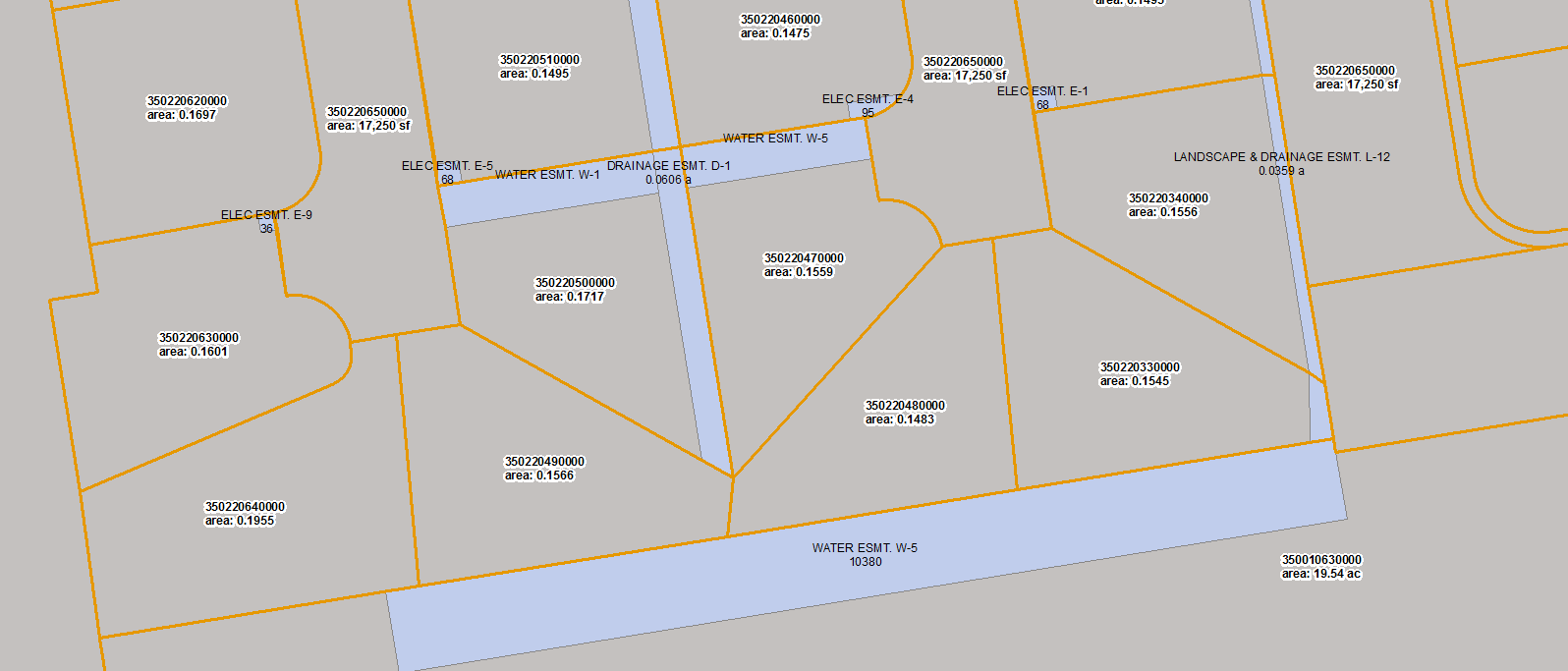

I have attempted:
[PARCELID] + VbCrLF + "area: " + [StatedArea]
(This returns the desired label)
[PARCELID] + "\n" + "area: " + [StatedArea]
[PARCELID] + "r\\n" + "area: " + [StatedArea]
These return an expression thus

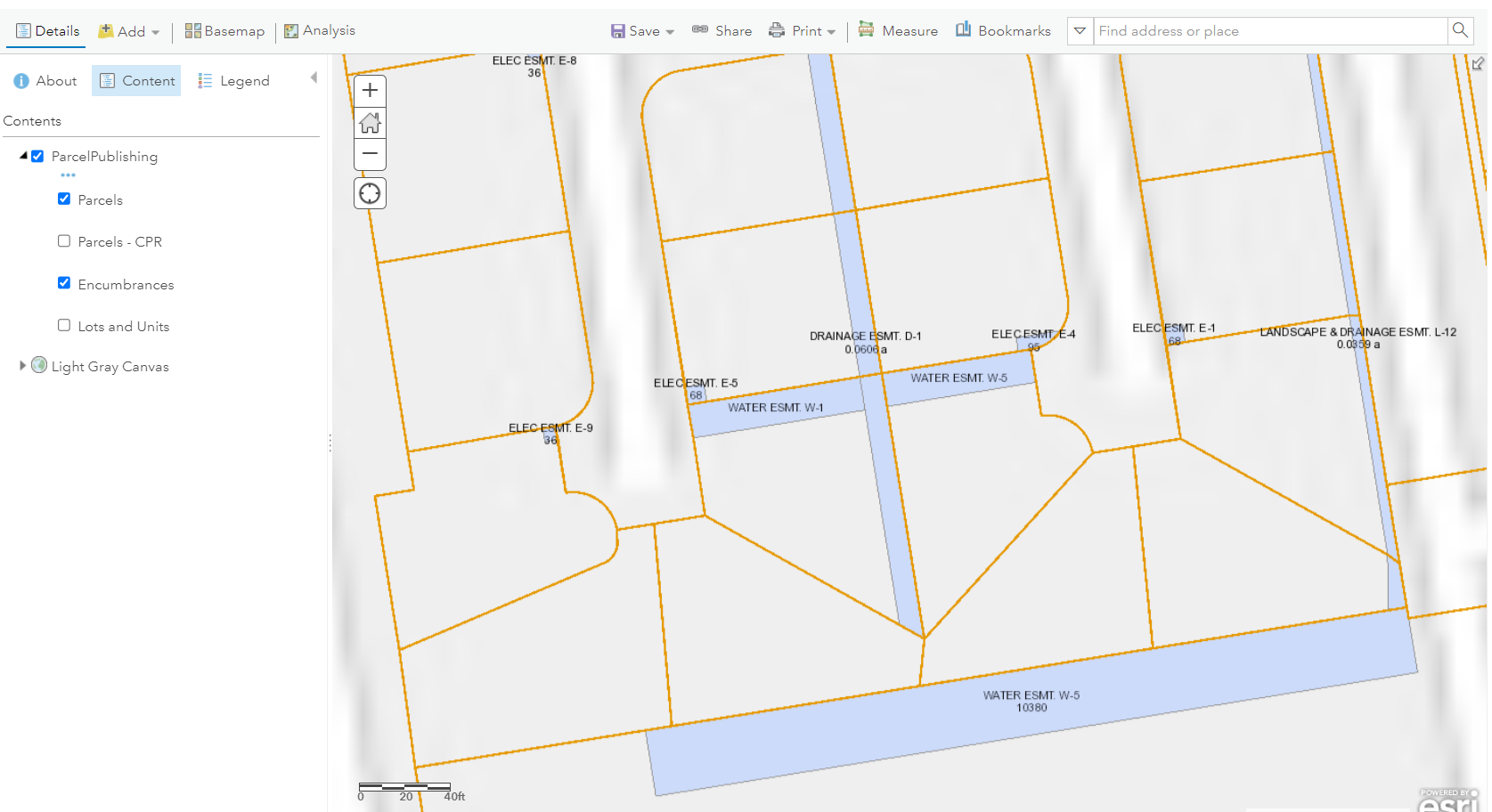

However, no matter what I have tried the ParcelID label will not appear AT ALL in the ArcGIS Enterprise Map Service.
I have tried changing the Scale Range, Standard vs. Maplex and various other settings that may affect the outcome.
In all instances, hhis is the resulting Map Service label return
Can someone please explain to me what I am doing wrong?
