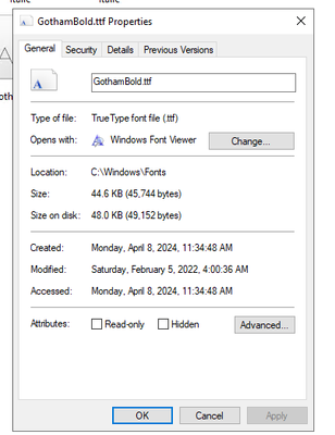

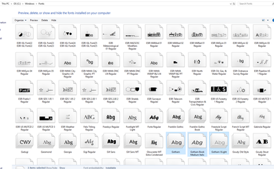

phess_luckstone
I have the font's installed on the machine.  Also Portal is installed on the same machine as our base deployment.  I have them as ttf files, are there other folders to install these into?

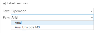

(From Experience Builder)
(From Map Viewer Classic)

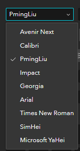

(From Map Viewer - Searched for my font and isn't there)
PaulJohns
Hi. By default, you need to simply double-click on the *.ttf file. All installation processes should take place in the Windows system directories. So, in your scenario, you’re using the same machine for both the "publisher" and the "portal deployment." In this case, everything should work properly after double-clicking each *.ttf file (make sure the installation completes successfully—the "Install" button should become disabled).
