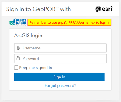

I have set up our Portal to use Windows Authentication, which works really well; however, the stipulation that we currently require is that instead of just using one's User Name and Password we require users to type in or Domain as well as User Name, as per below [for the record, GeoPORT is our internal name for our Portal here at the Port in Prince Rupert :-)]:
However, this also causes a point of grief as I get calls all the time from staff who state that they are unable to log in, and 99% of the time it's because they're not keying in <domain>\ before their User Name.
What I would like to be able to do is add an instruction to the sign in screen that reminds users how to properly sign in to Portal, as per the example below:
Would this be possible to configure in Portal?  It has been suggested that one needs to edit the oauth2.js file, but I don't seem to be able to notice any differences to that file after making minor (temporary) edits.

Admittedly, none of this is my forte and I'm struggling to start.  How does one edit the oauth2.js file so that changes will be reflected in the Portal log in screen?  If I can learn what needs to be edited by making a small change and seeing that reflected in the login window I can then start to add HTML code to enhance our Portal login experience.  Ideally, something like this would be perfect for our organization:
I have tried to edit this file (using Notepad++) to make a minute/subtle change to see if this works (i.e. if I could get that to work then I would know that I'm at least dealing with the correct .js file), but none of my changes made any difference.
